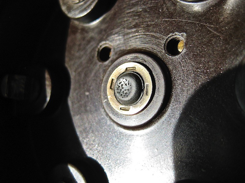

    Another issue - after the MOT I had a look at the distributor cap - the carbon brush had completely disappeared! The engine was running ok but there must have been a tremendous arc! I got a new cap from Sue Wheildon as we had ordered a batch from the Distributor Doctor - perfect!
      Guy,
      I had a somewhat similar occurrence. One day I observed the carbon button was pitted. I found that the cause was that the spring contact on the rotor arm was not making contact with the button so I adjusted the height, cleaned the button and all has been fine since then. I was surprised how much the spring needed adjusting to get proper contact!
