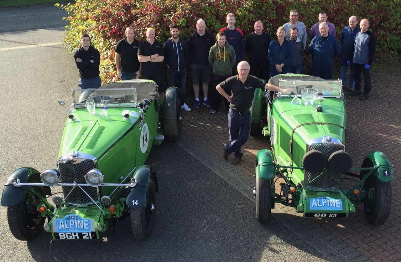

    Ladies and Gentlemen! Now I have your attention with a picture I took at Pace Products of the successful 2016 Alpine Rally 'Works' 105s and (of course!) my own "Fuggle", I have a question for you!
