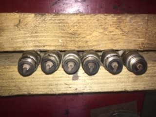

Dick,
Is it possible to get a sharp close up of the strap electrode - I am interested in the markings as you progress from the tip to the base as this can reveal information on the heat range match. Looking at NGK AB6 plugs it seems that the Champion equivalent are the D16 and the D14 whereas the Champion equivalent for the NGK AB7 is the D9.
