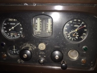

        Hi Gordon,
        It seems that if you didnt have a tacho you got a large clock in the space where it would have been. If you had a tacho, the clock was part of it.
        see attached.

          Hi Dick,
          Many thanks for posting your combined tachometer and clock. It is the first time I have ever seen one!

            Hi the BA 75 has a tachometer as standard, with a clock in it.
