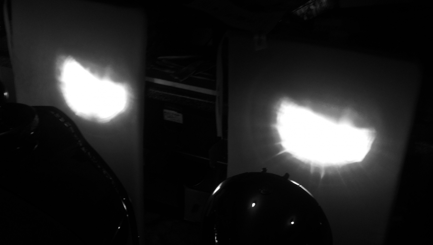

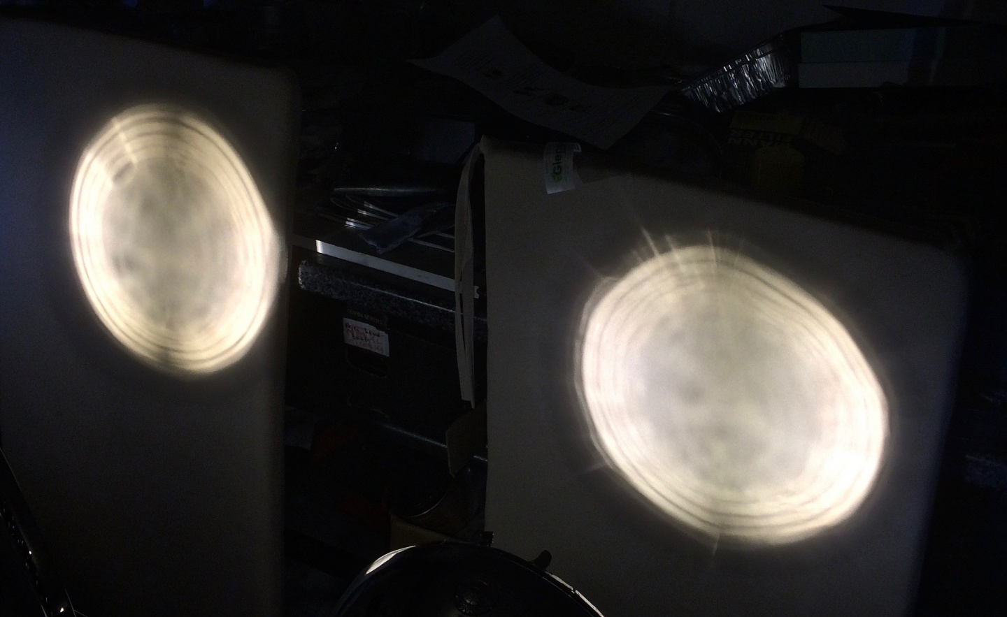

          The main problem is that the Rotax 590 parabolic reflectors are not designed for a modern twin axial filament with a Graves mask to get them both in focus. The LED units I selected were H4 type but with a removable mounting plate that allowed them to be fitted into the standard ba15 tube so could be moved axially and clamped in position allowing focus to be adjusted. Attached are the beams produced without the front lens. What is needed is a front glass that is ribbed to spread the beam horizontally. The Model A Ford of 1928 has a simple ribbed design and is 8.5" diameter so could be trimmed to fit if it does the job.
