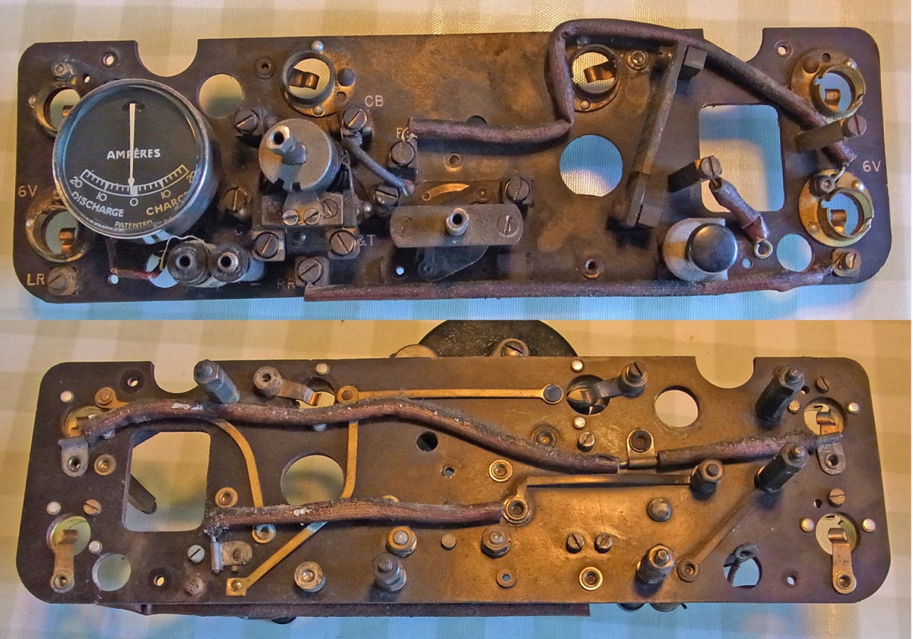

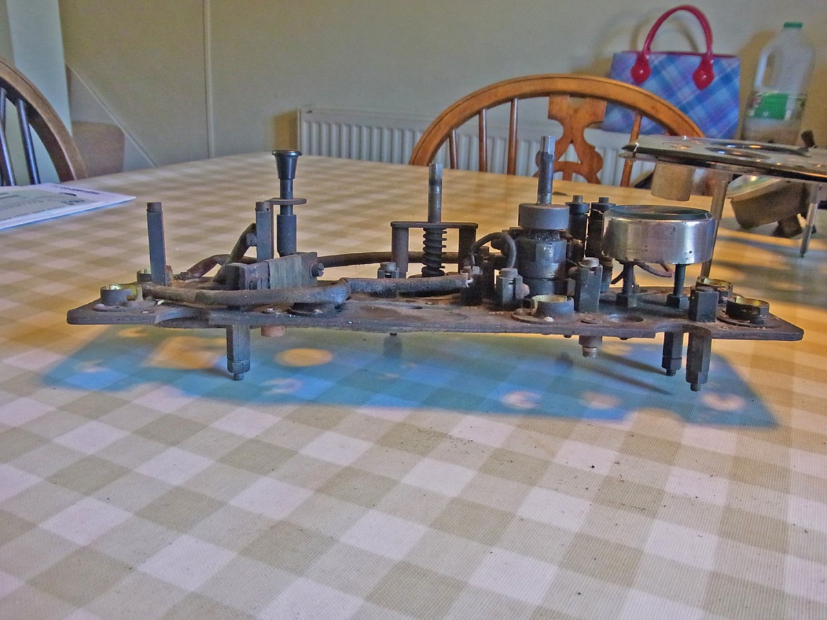

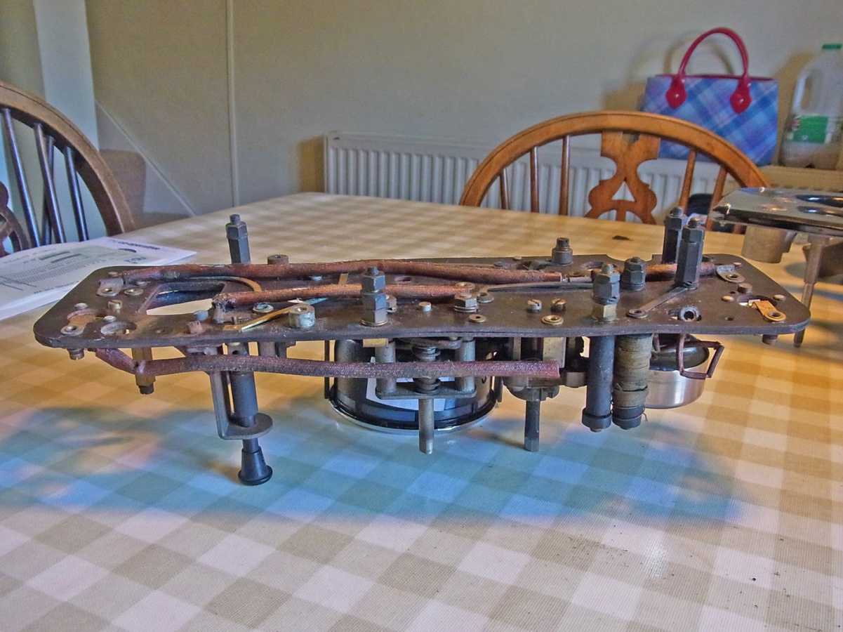

              Click image for larger version
Name:	Talbot AM75 Instrument board side view.jpg
ID:	1061 Click image for larger version
Name:	Talbot AM75 Instrument board side view 2.jpg
ID:	1062 Click image for larger version
Name:	Talbot AM75 dash panel before rewire.jpg
              Comment
              • #8
                Hi Markus.
                I'm sorry to hear about your issues. Above are photos of my AM75 dash taken a few years ago. I hope they will provide some help.
